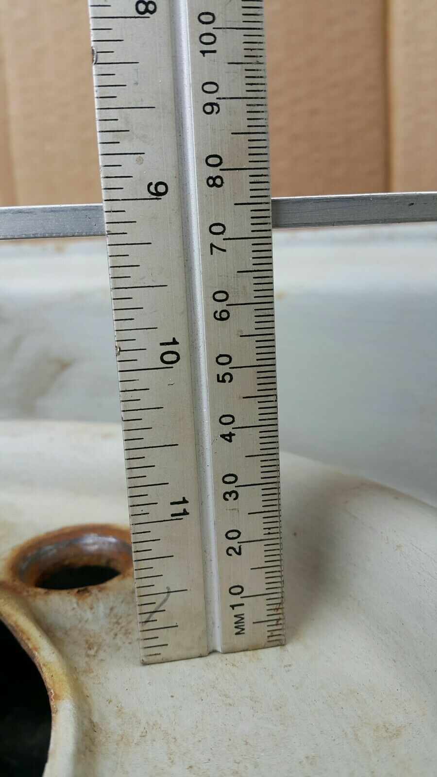

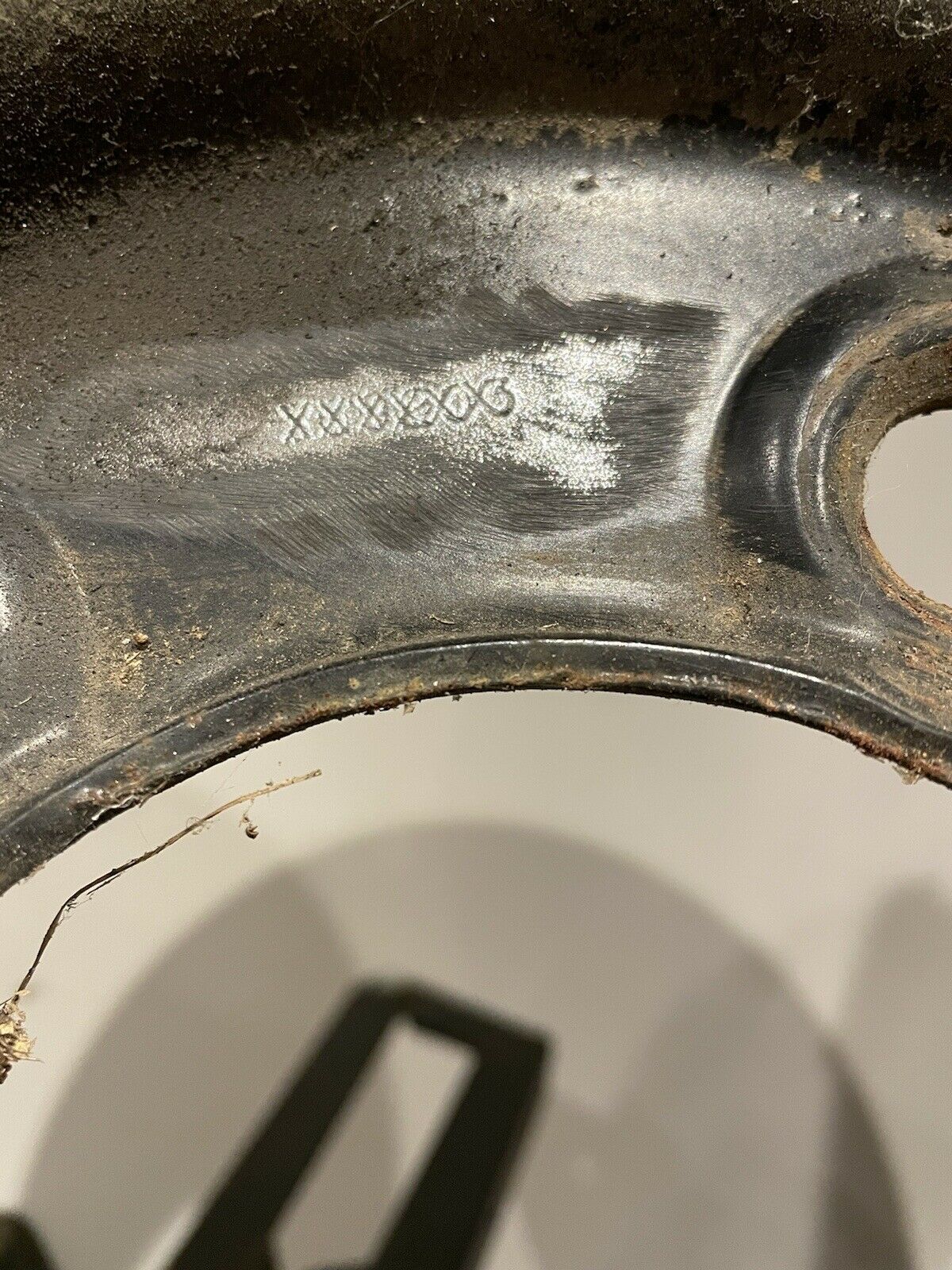

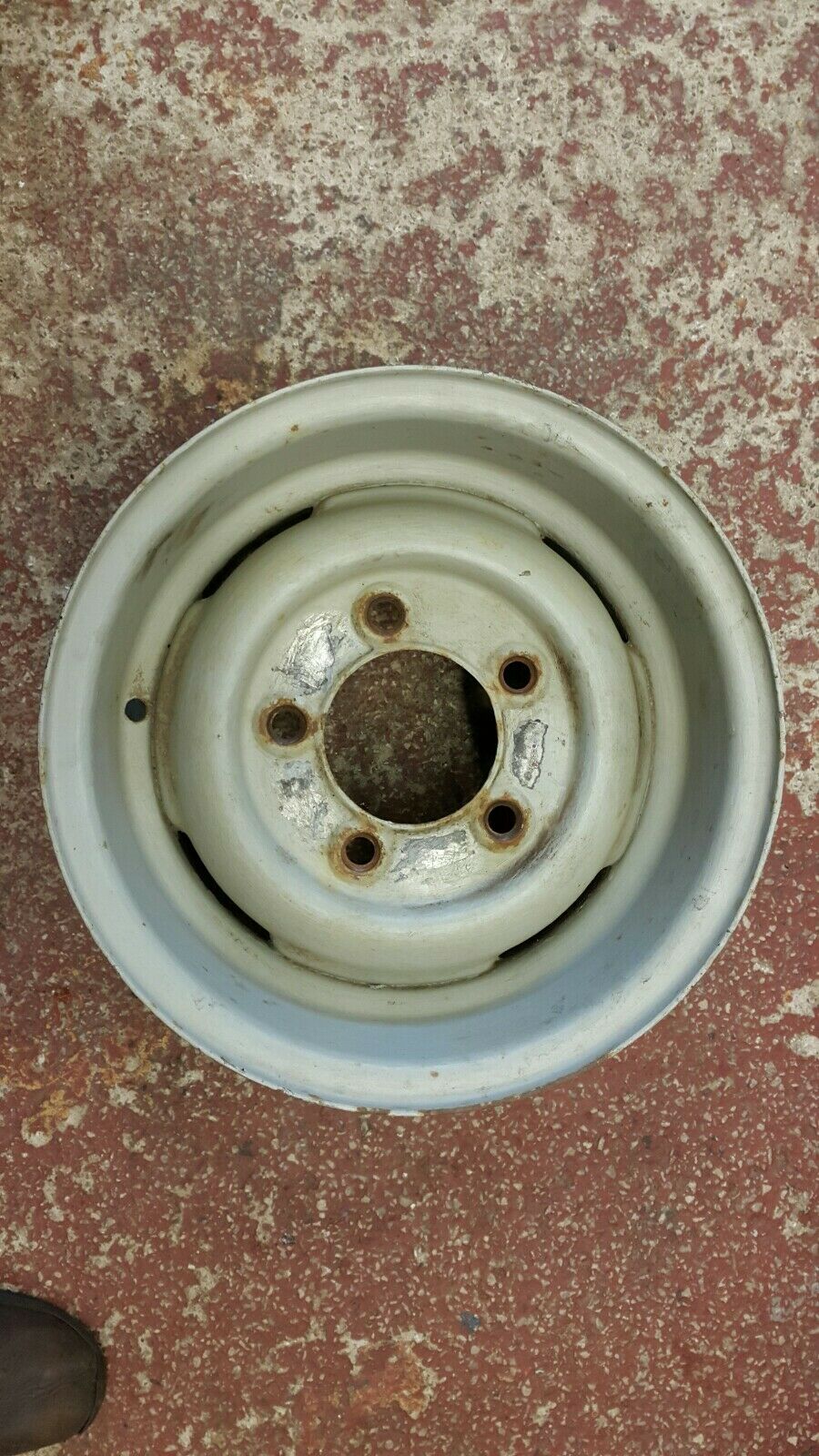

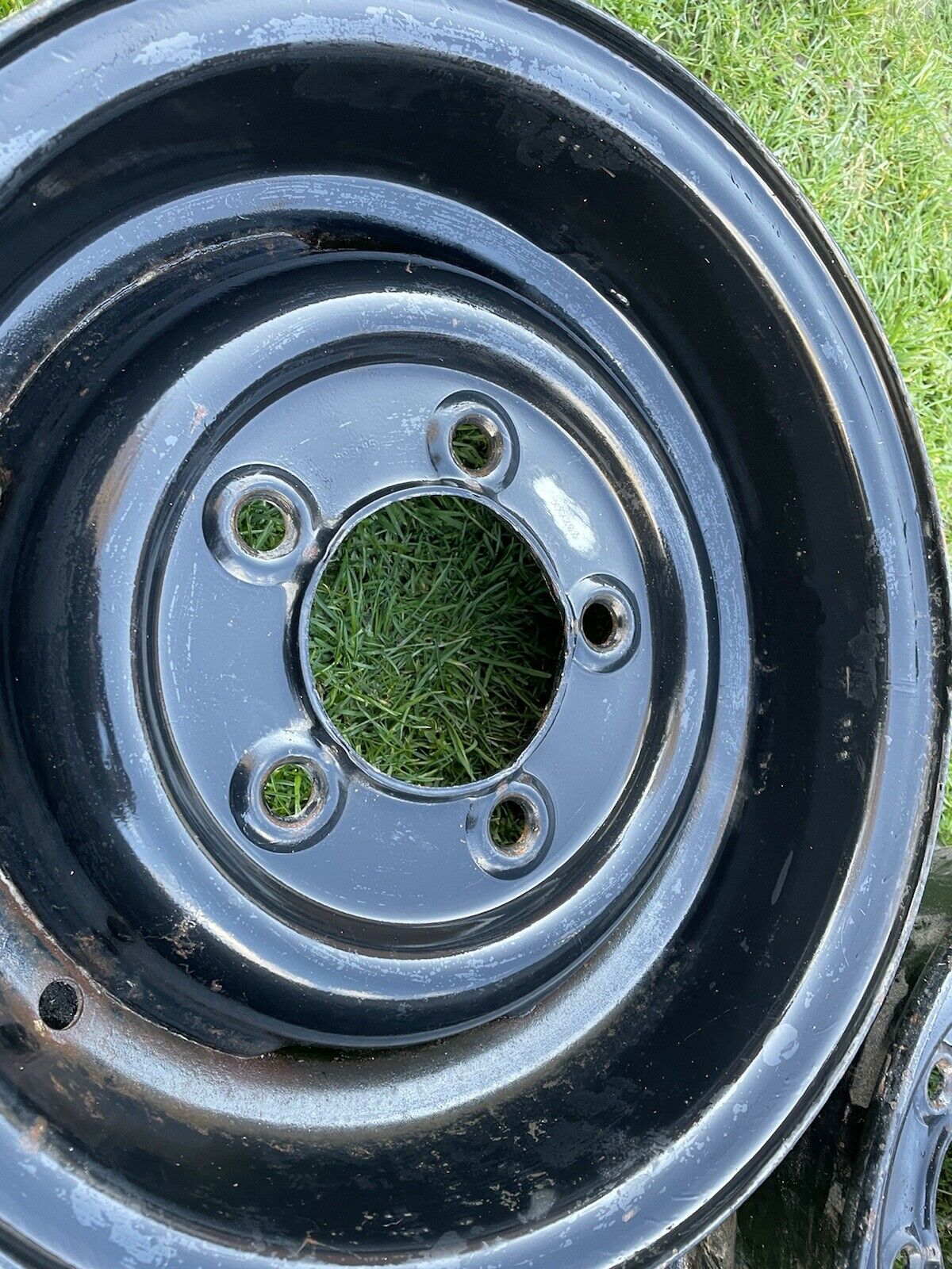

Is this a correct "erroneous" Type 7 Pressing C rim? The deepset is 72mm, not 78mm.

Cheers.
Postby 22900013A » Wed Nov 03, 2021 3:14 pm
That looks to be a 569204 mis-stamped with XXXX over and then the correct 4 over the 3.

Agreed. The buyer's guide says they should be 78mm deepset. I have seen several of these now and they are all 72mm.

By "these" I am referring exclusively to the "erroneous" Type 7 Pressing C rim.
I have now found several of "these" rims, all of them have a deepset of 72-73mm. Here's another ...
