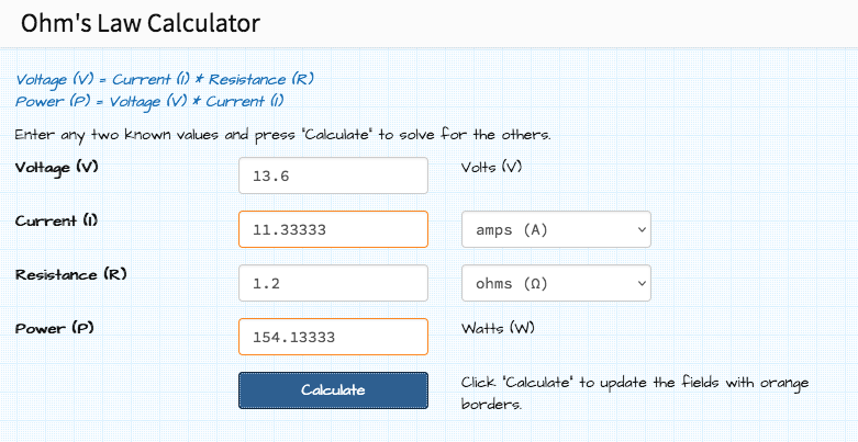

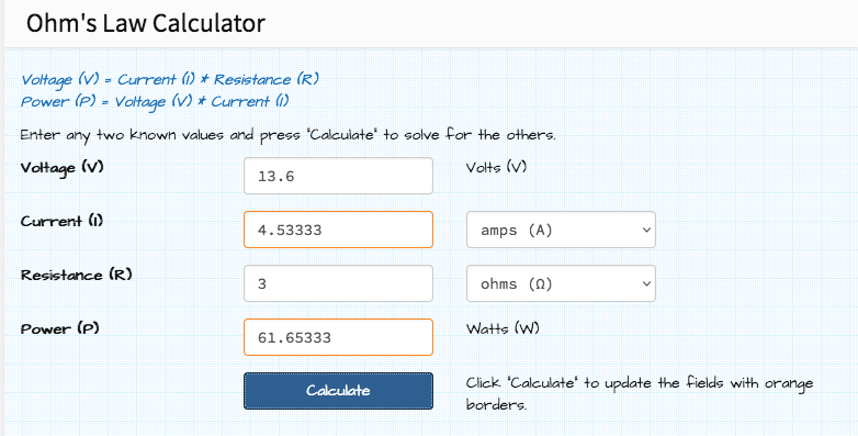

If it's 3Ω it can't be a high-power coil. The laws of Physics and Ohm's Law makes high-power impossible... I'll cover coil-power, vacuum and variable-dwell too. Running them straight from the pack - thus not coil-power matched - too many won't gap their classic's plugs.

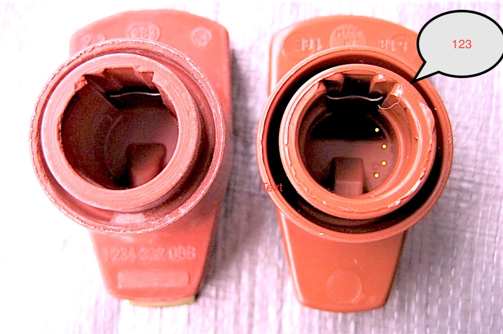

You want the Beru original. And here's why....

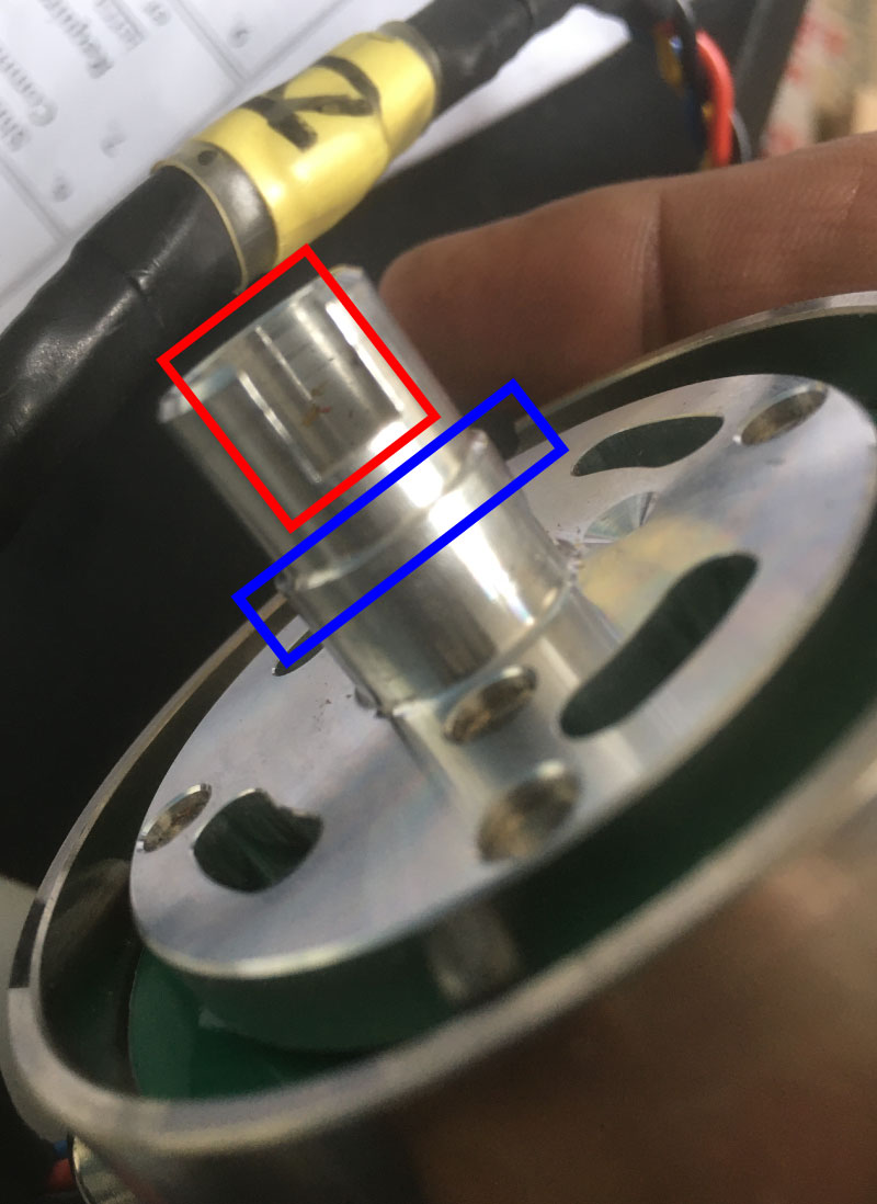

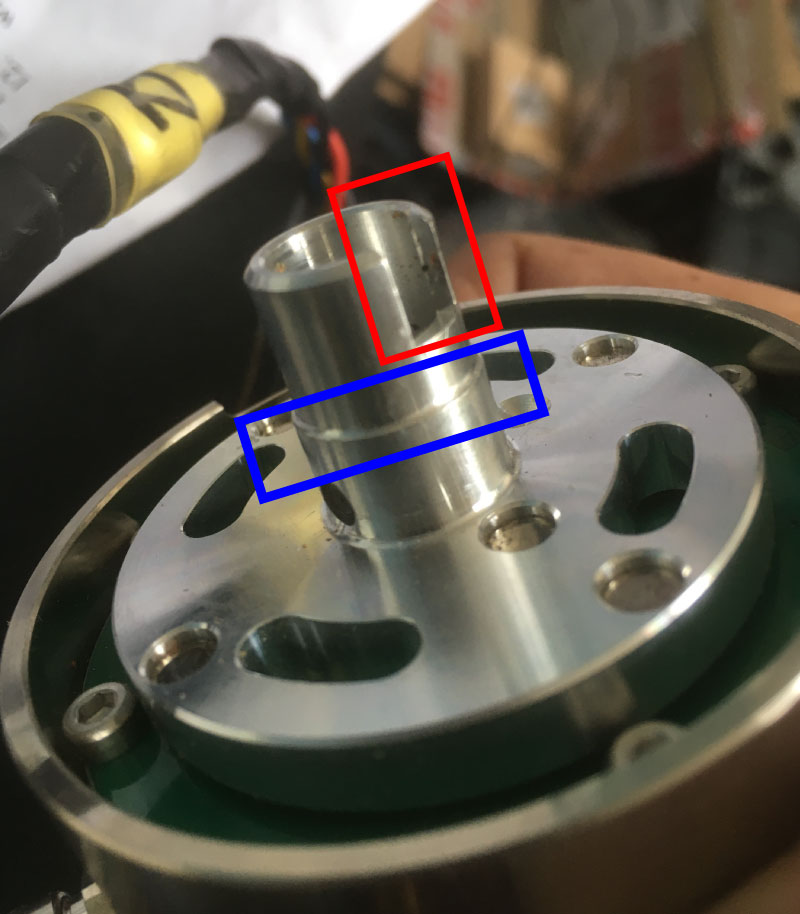

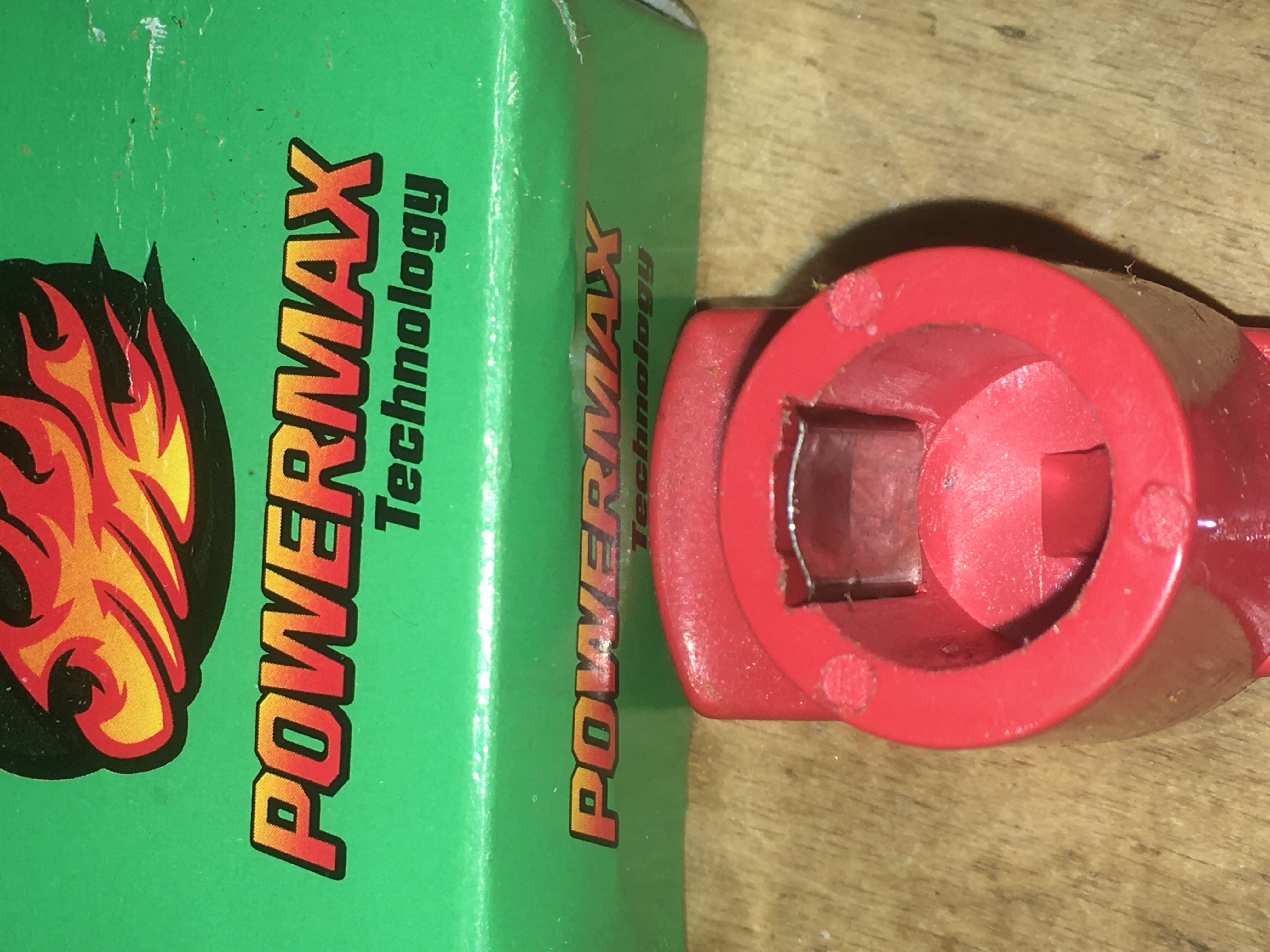

A1: (See the area marked Blue ). There's a step/ narrowing to the spindle on 123Ignition distributors.
B1: (See the area marked Red ). The cut-out / clocking lug is wider than most.
The effect of A1 - SimonBBC's rotor-arm (and the others inc. Bosch) are found too wide, thus have play - they'll wobble on the 123Ignition spindle.
The effect of B1 - This has the rotor rotate roughly 5 degs - which if you've in a timing-light session anyway will be accounted for, and if you've not (very possible?) this will throw the timing. The wobble you'll see gave mine very spotty timing. It was this sudden 5-6 degs timing-difference which brought the whole rotor thing to my attention.
REMEMBER: Your DIZZY runs HALF the speed of your CRANK. Thus one or two degrees of slop at your rotor arm gets DOUBLED at the CRANK.

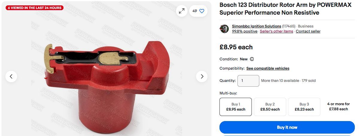

Which is not so different to what you get from one eBay seller. Note the parrallel bore. See above.

Speak to sellers about the dubious fit, and you'll be told they've sold hundreds like this without issue? Yours truly is forced to admit, the idea that hundreds of classic-car owners buy any old shonk... and STILL... yes stilll won't notice is VERY believable.
When your customer is a fool... read the internet forums on the subject for proof.
Says here, fits 123. See it swing in the breeze.

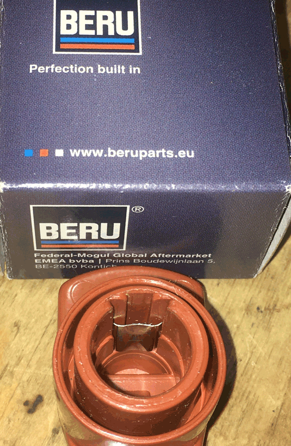

Next.... Beru et al.

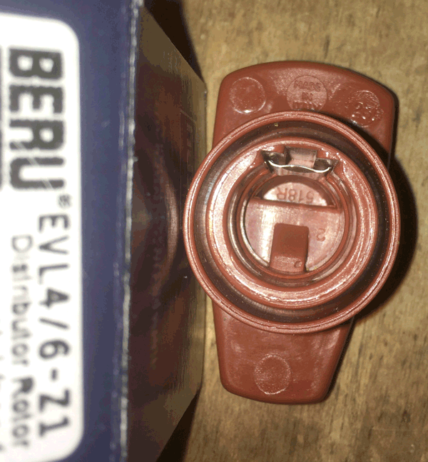

Here's the kiddy. See the part number. I picked these up for £5-6 each. Bought three.
www.sparkplugs.co.uk
Paid about what you'd pay for one proper Beru any where else.
Note the step in the bore, and the chord / / half-moon tooling which clocks the arm to the spindle.

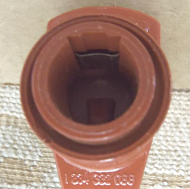

Compare. That pic of BOSCH 1 234 332 088 again. Sale Ends Soon.
Mind, this is a lost cause. Beru insist their equiv. is BOSCH 1 234 332 088. It isn't.

BOSCH 1 234 332 088 versus Beru. This pic courtesy of others discussing the same issue.

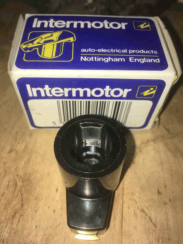

However if you're desperate, only not ^^beyond hope^^: I found Intermotor 47110S - It's lug is wide - whilst well short of perfect - it will move timing 5ish degrees - it's the best stop-gap.

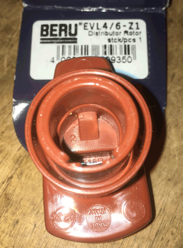

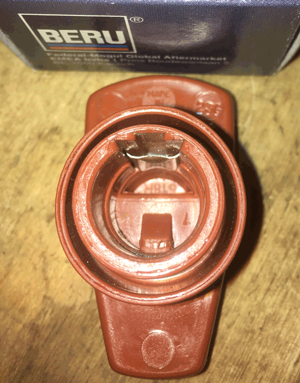

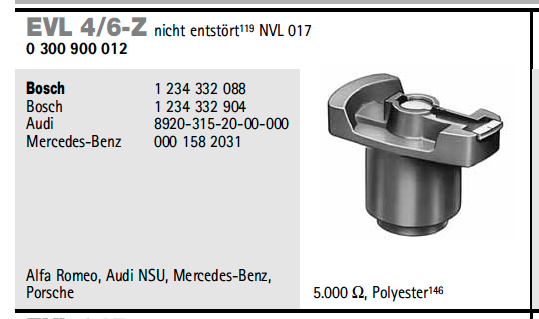

The Beru original arm
In mass production, BERU EVL4/6-Z has the tooling we require. Last seen standard-fit on Porsche 356; some 60s Volvos and Merc W108. There can't be too many 60s Volvos and Mercs, still sporting their original dizzy? And a Porsche 356?? This rotor must be pretty obcscure.

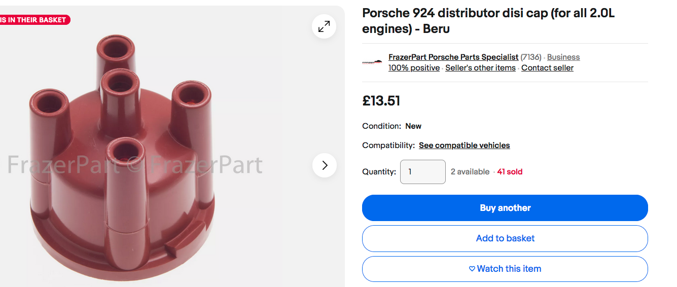

As said, the four-pot cap comes easier. I found if I sourced a cap for a Porsche 924, a Beru. Your mileage may vary.
Resistance
As supplied the BERU EVL4/6-Z has 5kΩ. Some of you want 0Ω. Beru NV017 is 0Ω with the correct tooling, thus identical without resistor. Good luck sourcing those.

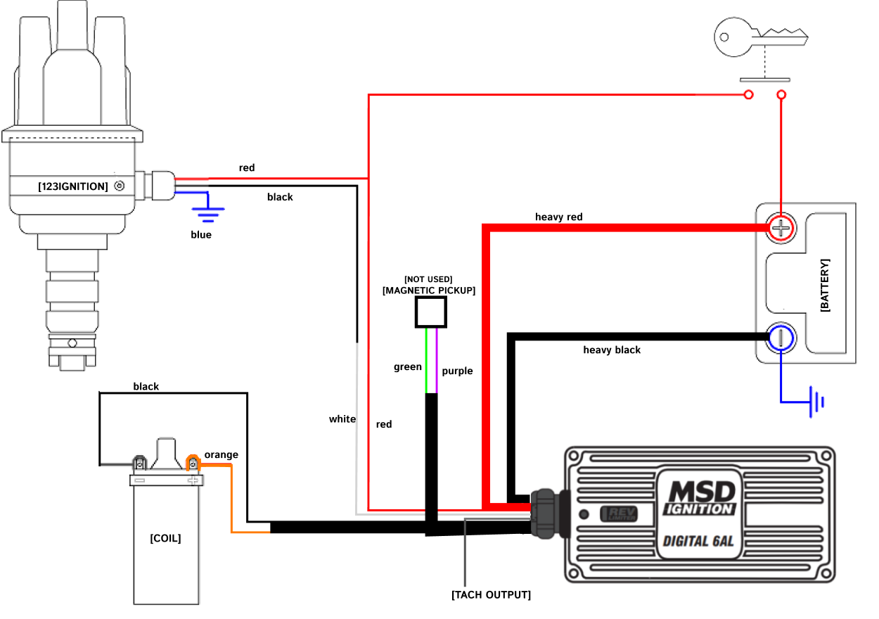

Seems any rotor arm at 0Ω is pretty rare. You're making your own. There's stuff if you search, showing people digging out the resistor and soldering solid copper/brass - this into stock BERU EVL4/6-Z arms.
There's a Yank seller putting out low 0.2Ω arms with correct fit too.
https://123ignitionusa.com/rotor-for-al ... esistance/
I gather required for CD ignition. MSD etc. Repeated high voltage spikes from multi-spark CD ignitions mean the stock resistor rotors fail.
Resistance

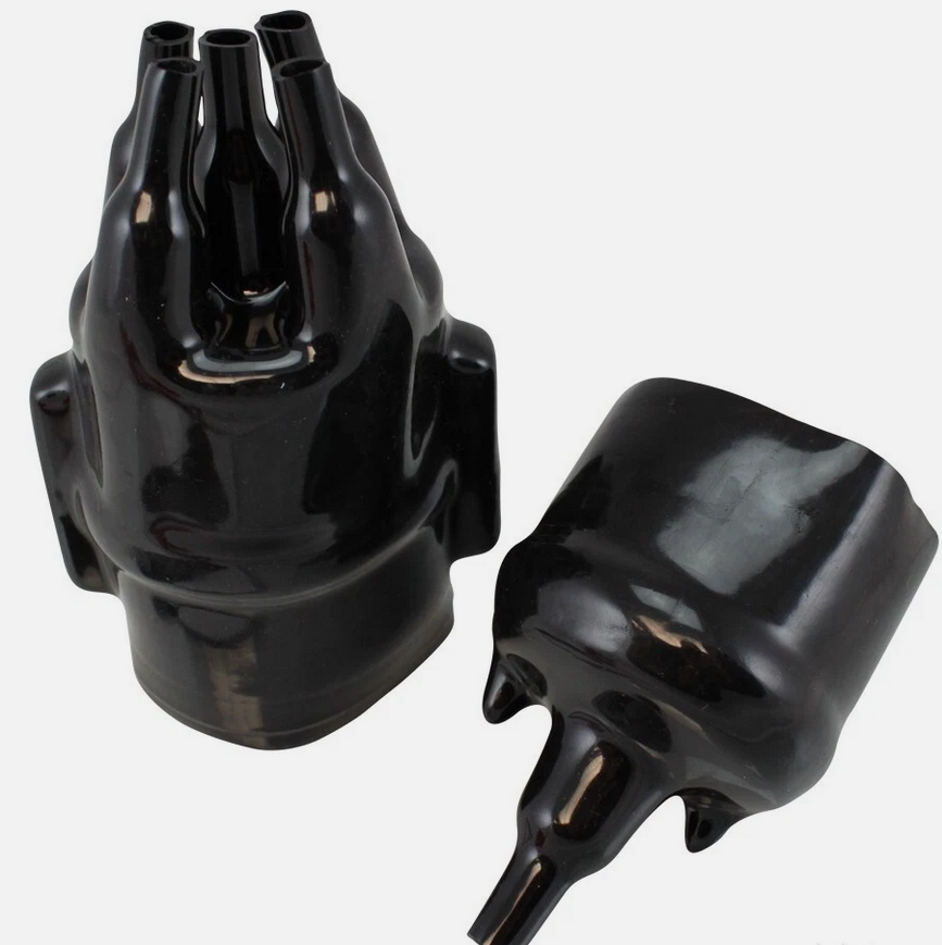

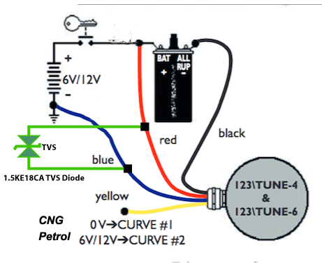

Two useful mods:
1) Get yourself a waterproof cover.
Sold to the Beach-buggy crowd - I got myself a VW cover. If any MGB B-Series owners are reading this, you know all about leaking heater tap drain-valves not mixing with 123. A VW 'shower-cap' is essential.

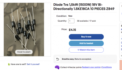

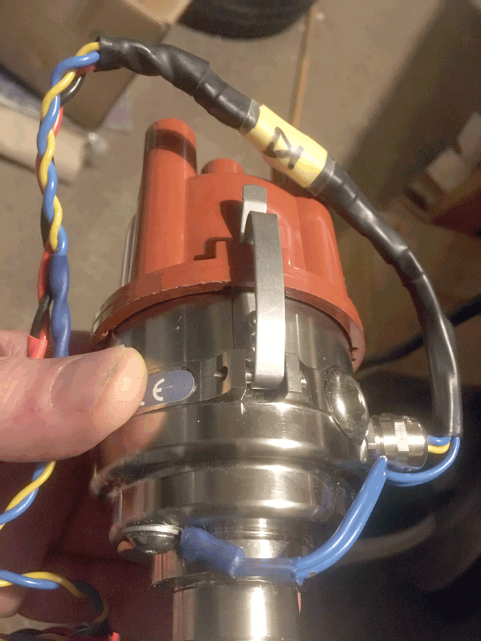

2) Solder in a TVS Diode [1.5KE18CA] as shown.
They're under £0.30p each, yet with postage and min.quantities you'll probably finish with a dozen and pay a fiverish. It'll protect your pricey 123Ignition if there's ever an over-voltage from an iffy alternator or similar. Only the twin-curve variant of 123 has the yellow wire.
Note use of the proper earthing on the dizzy body, there's threading for it - focus on decent earths with electronics - very important you use this. This is the usual reason you'll hear failure complaints with electronic-ignition conversions. Most half-arse this.

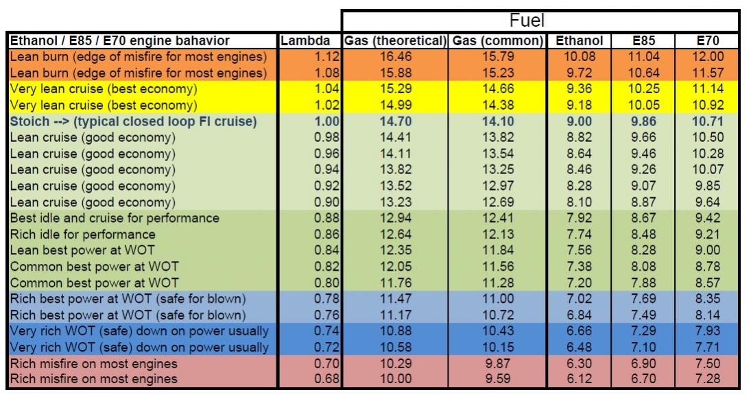

No flat-spots, no stench of fuel, a properly set-up classic is a joy to use. It was usual for cars in that era to run well-enough fresh out of the factory, yet not be 'strictly right'. Low-power 3Ω coils fueled engines as 'rich'... limited by points... that's just how it was.
Fuel was cheap. Poor starting in February was usual. It was the Japanese who first started used proper ignition as a standard-fit.

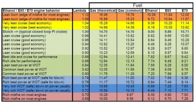

Be minded, modern ethanol fuels are harder to light and slower burning. Ethanol wants more advance and coil-power to light-up. A 3Ω will still work if rich, it just won't be optimal. And with the water found in modern fuels, buy some fuel stabiliser. If you're leaving it over winter, suggest you use Stabil Storage or 360 for a daily.

Two useful mods:

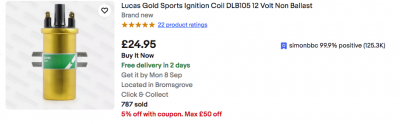

Now you have a better grasp of ignition-power, don't get caught by coil-marketing BS...
Many sellers of coils are at it. Instead of coil resistance, they'll use meaningless words like 'Sports' and 'High Performance'. This preys on how buyers understand ignition. Simple Ohms law exposes the lie.
https://ohmslawcalculator.com/ohms-law-calculator
See the current drawn with the resistance values. 11.3 vs 4.53 Amps. Over double the coil power - that's a vast difference.
Ohm's Law in school -
Your spotty 13-14YO self did Ohms Law in school. If the total load on your ignition is 2.5-3Ω, high-power performance ignition is impossible.
The words 'Ballast coil' or '3Ω' and 'Sports etc is a contradiction. In short select coils by resistance. Run as low as your set-up will allow.
