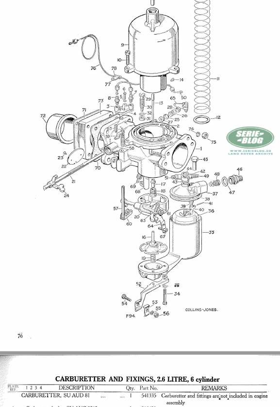

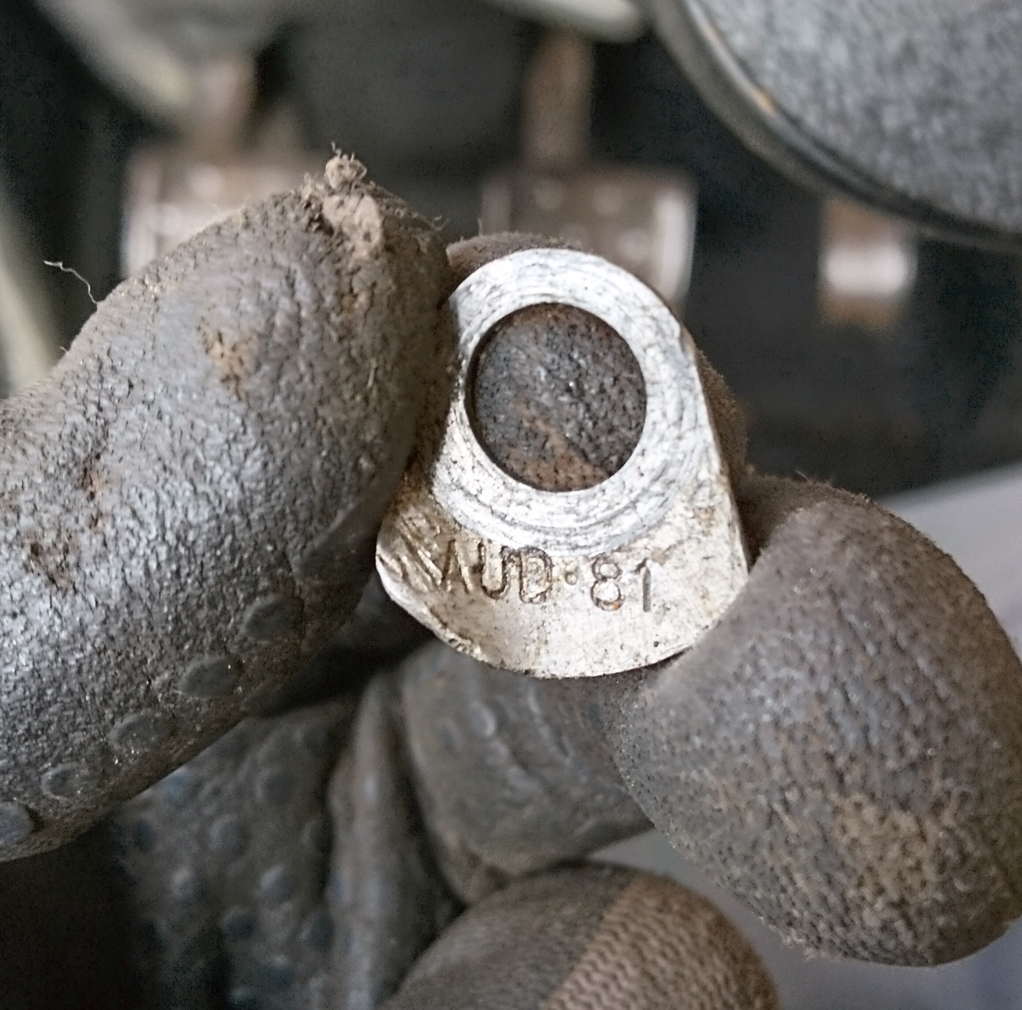

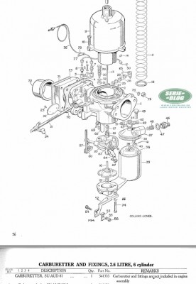

My FC IIB 2.6 petrol got a SU mounted , plate on it says AUD81. Considering the low mileage and general unmolested state of the vehicle i think this is its original configuration.
Apart from that, the Parts catalogue says so
best regards
Alex
Alex
