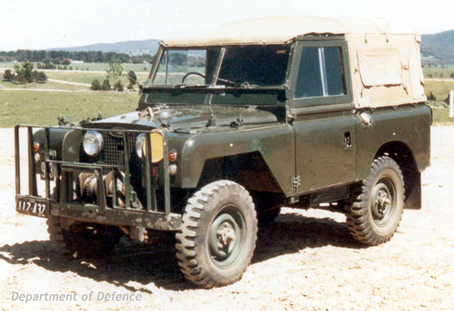

Australian MOD 88's and 109's had two tanks under the seats and outside fillers on both sides.
1963 SIIa 88" with 'some' mods.
