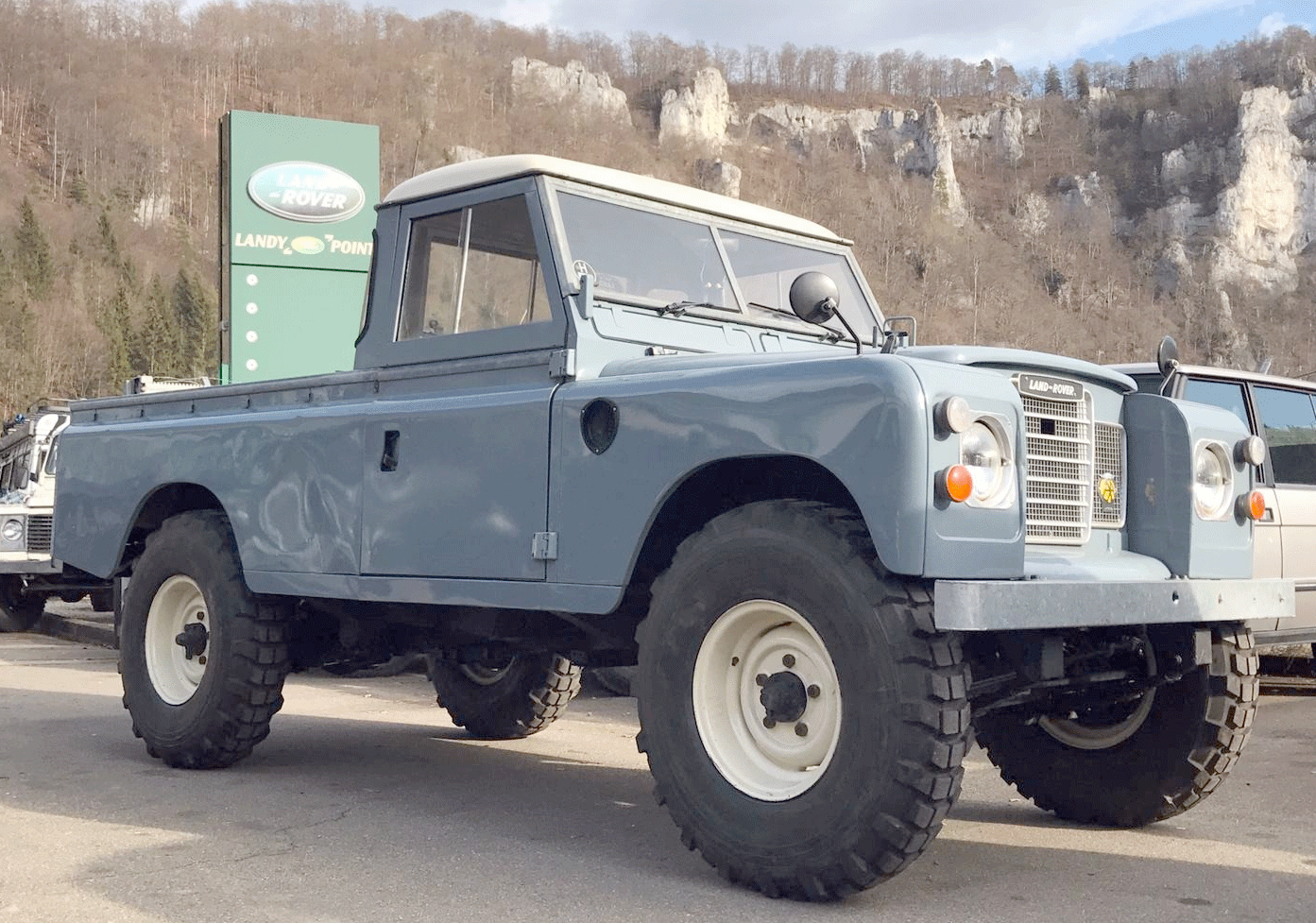

The One Ton Rim Part Number 569204 6.5J: A tubed rim. [Deepset measures: 78mm] Not to be confused with the 6 stud One Tonne rim.
Here we are talking about original fitment to the 109 One Ton, with the usual 5 -stud setup. Despite the parts book, this rim was also found on the FC and the TACR. Relatively common in the UK.
Schnice on this S1. Enthusiasts are keen to grab these.

One ton In Portugal
The owner of this Stagey bought another set from the stash of yours truly last year.
