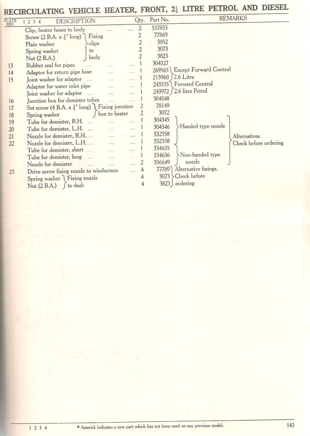

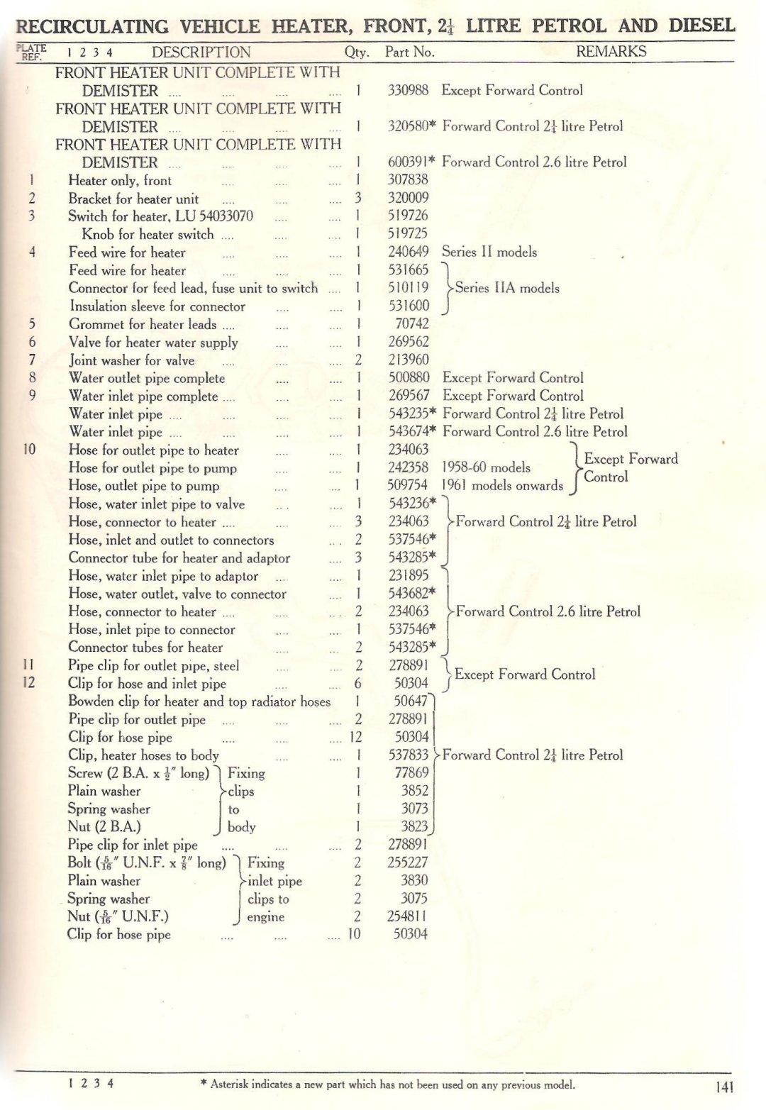

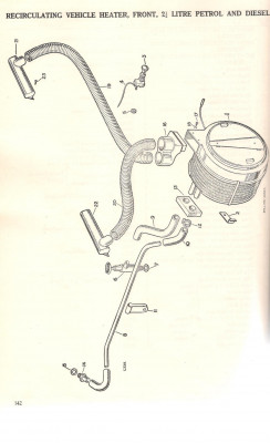

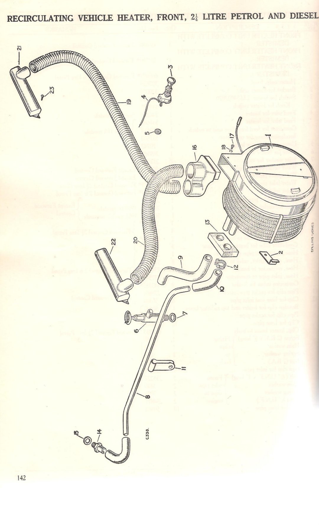

Hello PPN53,
I have scanned & attached the section on the heaters. Looks like the FC only uses the round Smith type. The 'Fresh Air' type is for LHD only and not available for the FC.
