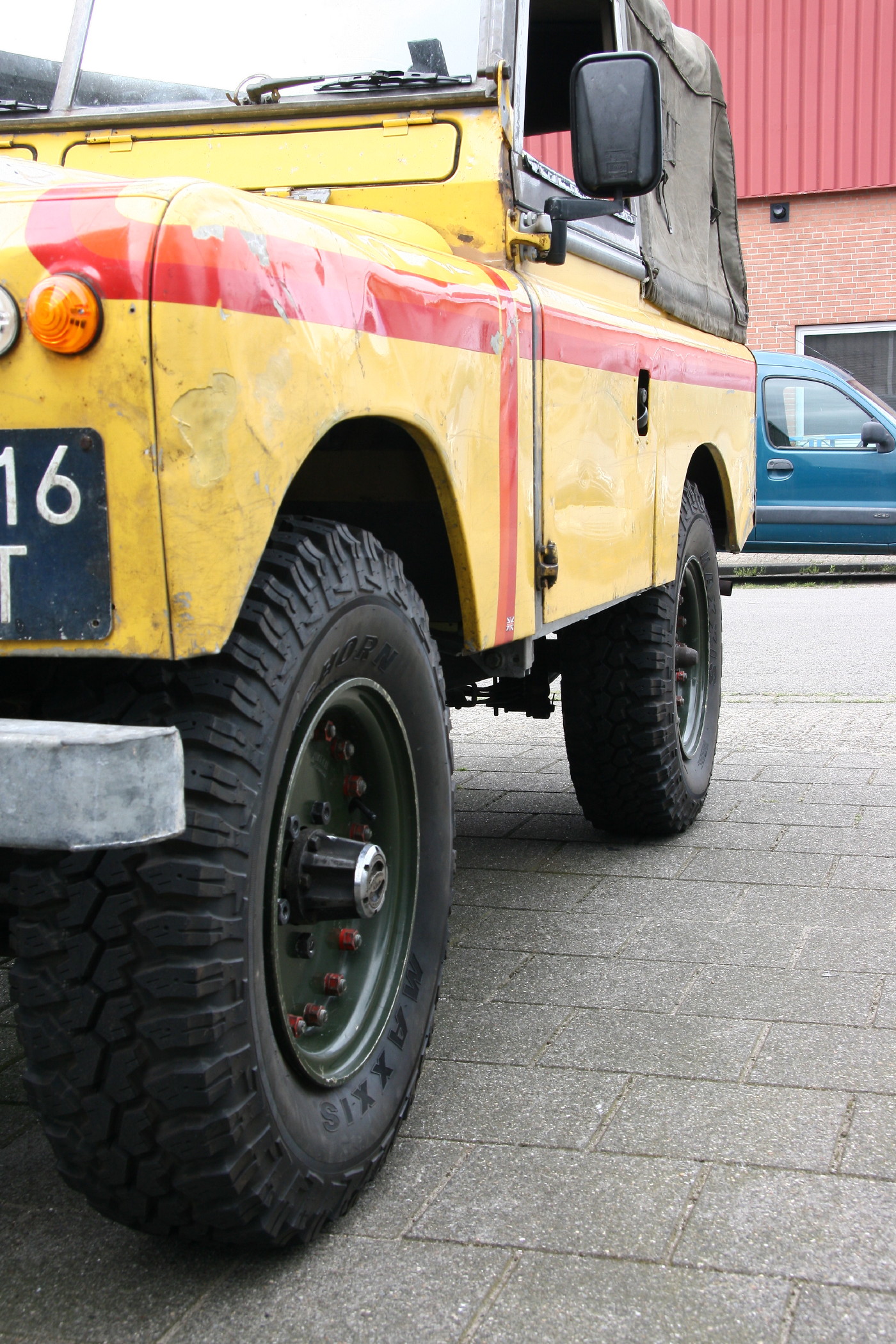

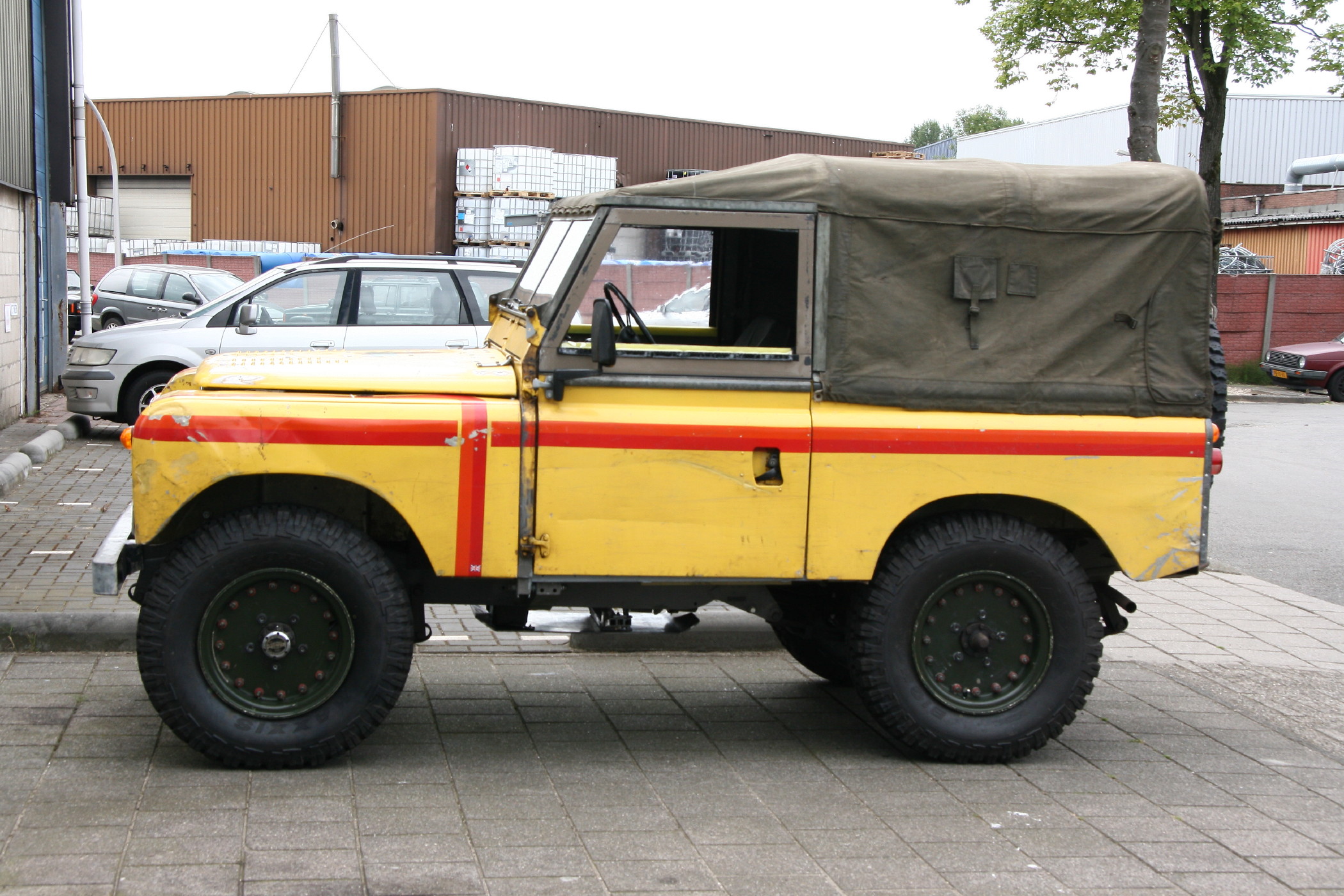

Some Shorlands had a dividable forged aluminium 6,50H x 16" rim. The H type rim has a 28 mm tall rim bead where the regular J type has only 17 mm rim bead height. In the pics is my 88" sporting a set of those, fitted with 255/85 R 16 tyres.
1963 SIIa 88" with 'some' mods.

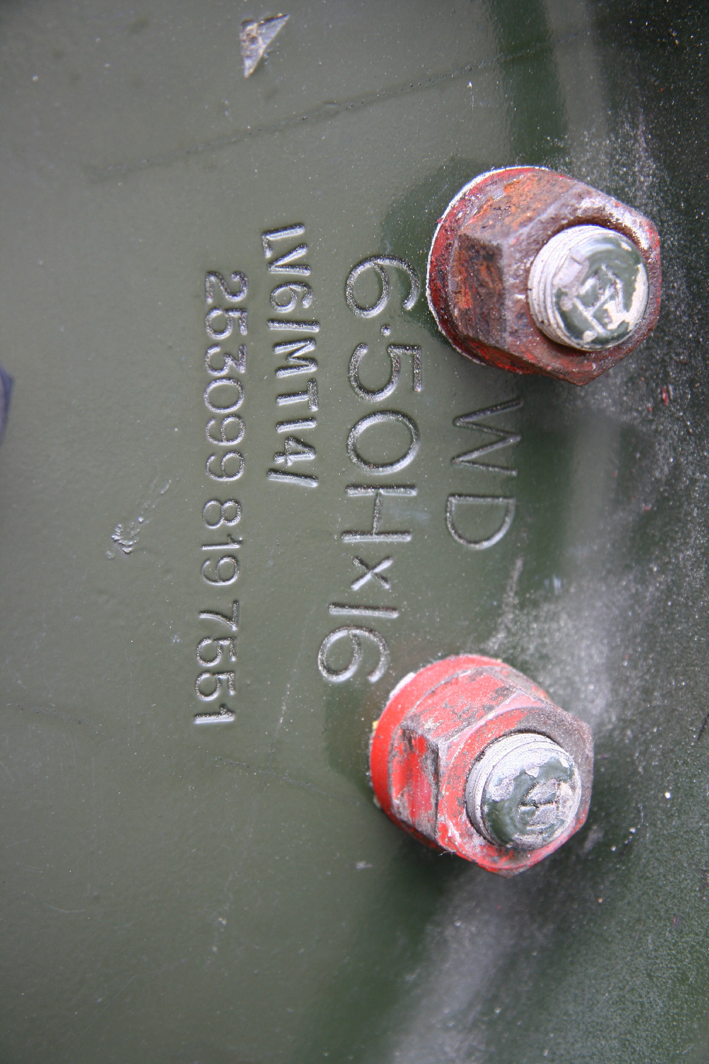

Just in case you're interested in part number and such, this is all I have. Could it be "WD" stands for War Department ?
For reference, the nuts holding the halves together are 24 mm AF.

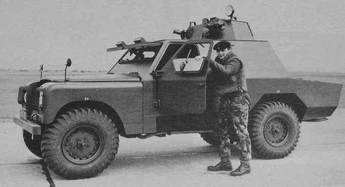

Shorland Mk3 . Same rims as mine, made by Sankey. Bought my set of 5 brand new, army surplus in 1982.
Being a two piece rim without a recess there is no way to mount a tyre on a machine. You need to take the rim apart. Huge benefits are you can never loose a tyre due to low pressure and you can fix a flat just about anywhere. Good inner tubes and a flap are mandatory.

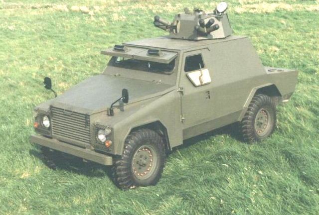

Not all Shorlands had these wheels but they were fitted on some 110" based Mk5's too. Even saw a Youtube clip where a prototype 101 FC was wearing these very 5 lug rims. Yes, I know, production 101 have 6 lug rims.
