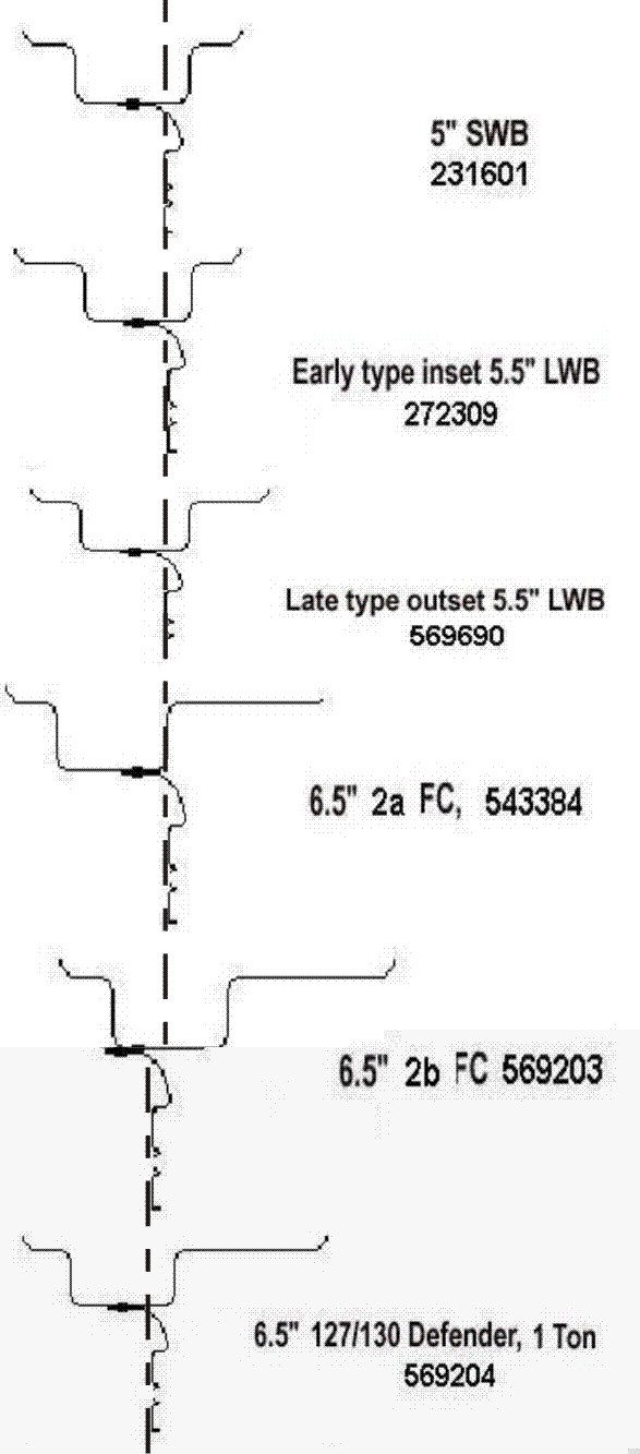

No rivets on this diagram. I cobbled it together from indivdual web-sourced drawings so I could line up the drum faces - makes it easier to see where the set comes and goes 8-)

Always a useful diagram. However as always, the labels could be considered misleading, as there was no such thing as a specific rim for a specific vehicle. 1-Tons were factory fitted with 569203 and 569204 rims, that's a fact. Likewise you could spec 5.5" rims on a swb if you so wished. It would be interesting to see what rims were fitted to FCs, based on period photos etc.

I have to say, it helps but I'm really not a fan of that drawing. Sorry to put a downer on it, but It has flitted from forum to forum to forum and whilst it gives a rough idea, it is pretty useless in the real world. It is also missing several rims, and as Dan says, gives the impression you can definitively name or number these rims. Which as Dan points out you can't.
It is also wrong.
It gives you a clue, but I defy you to identify all the rims from this. Sorry. One thing I can assure you of is that the 4 x 569203 on ebay right now are the only real-deal rims of this type I've seen for sale in nearly a 12 month. In four years of looking, I've seen not much more than a dozen real-deal rims for sale. Often sold one at a time. How do i know, I could argue taht diagram did me a favour, it means few knew what to look for! Before I wrote taht post I got most of those rims - Very rare.
