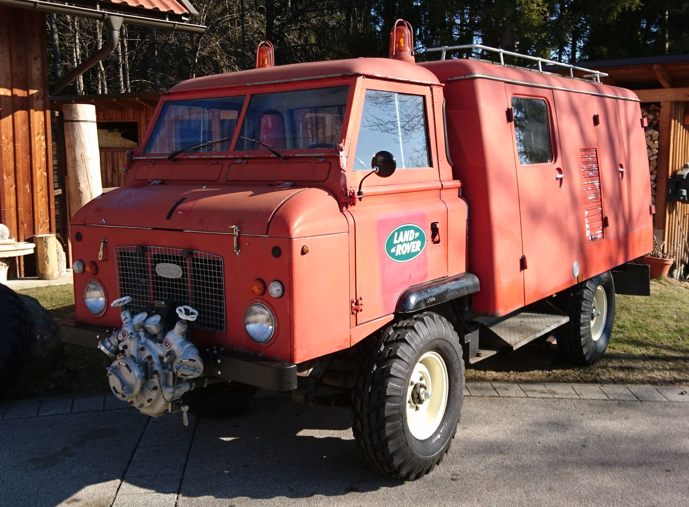

This is a standard 4cyl petrol ffr Ex MOD chassis , which got a civil crossmember from a former owner at sometime in its live, he probably didn´t know it better. So, sorry no One Ton :(
The 285/85 where supposed to fit on this :
But the Silverstones did rub on the rear spring ( probably beacause of the 543383 rims?), so until the wheel spacers arrive the FC drives on a set of 7,50 ( the speedometer reading is a bit off :roll: ) and the MT117 where used to roll the chassis arround because theres nothing they can hit at the moment :lol:
The MT117 where shoehorned on 543384 rims. I think they are supposed to fit on a minimum 7 inch wide rim, the guy mounting them wasn´t very happy and was cursing the whole time handling them.
Btw, the Mt117 mounted on the 109 chassis stick out of the tray, not much but they do, just saying.
