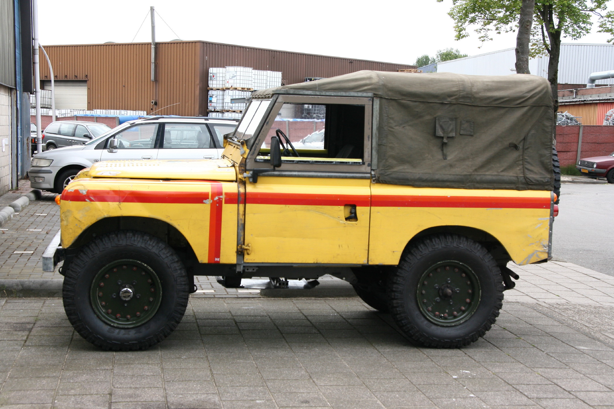

Does anybody have experience running true 900-16 XZL, so not the later 255/100 type on a 1-ton?
They appear (well they are) considerably larger and moreover, they are wider than the familiar NATO item
Have the strong suspision they will fit a FC, but will not clear the wings/tub on 1-ton. Espesially on 569203's
So before I go out and have them mounted just for a trial fit...
And also the look.... not sure I want to go for the wheel loader look on this.
For now I'll get the XY 900-16's (lower picture left tyre) mounted, but find them a bit becoming to look at, however they may actaully be a very good choice for drivability. (and this is the set mounted on rims and holding air, which helps shifting it around 8-) )
Like the XZL's though, may try to find a set of 8.25-16 (talking about hens teeth) if this doesn't work.

What are you doing with that XS tyre? And your camacs for that matter?
The one in your top pic looks too big to me. I think I had one on my 1-Ton when I first got it, very close to the bodywork from what I recall, but it was on the back, would probably have rubbed if it was up front, I get occasional rubbing with XS's which are quite a bit smaller.

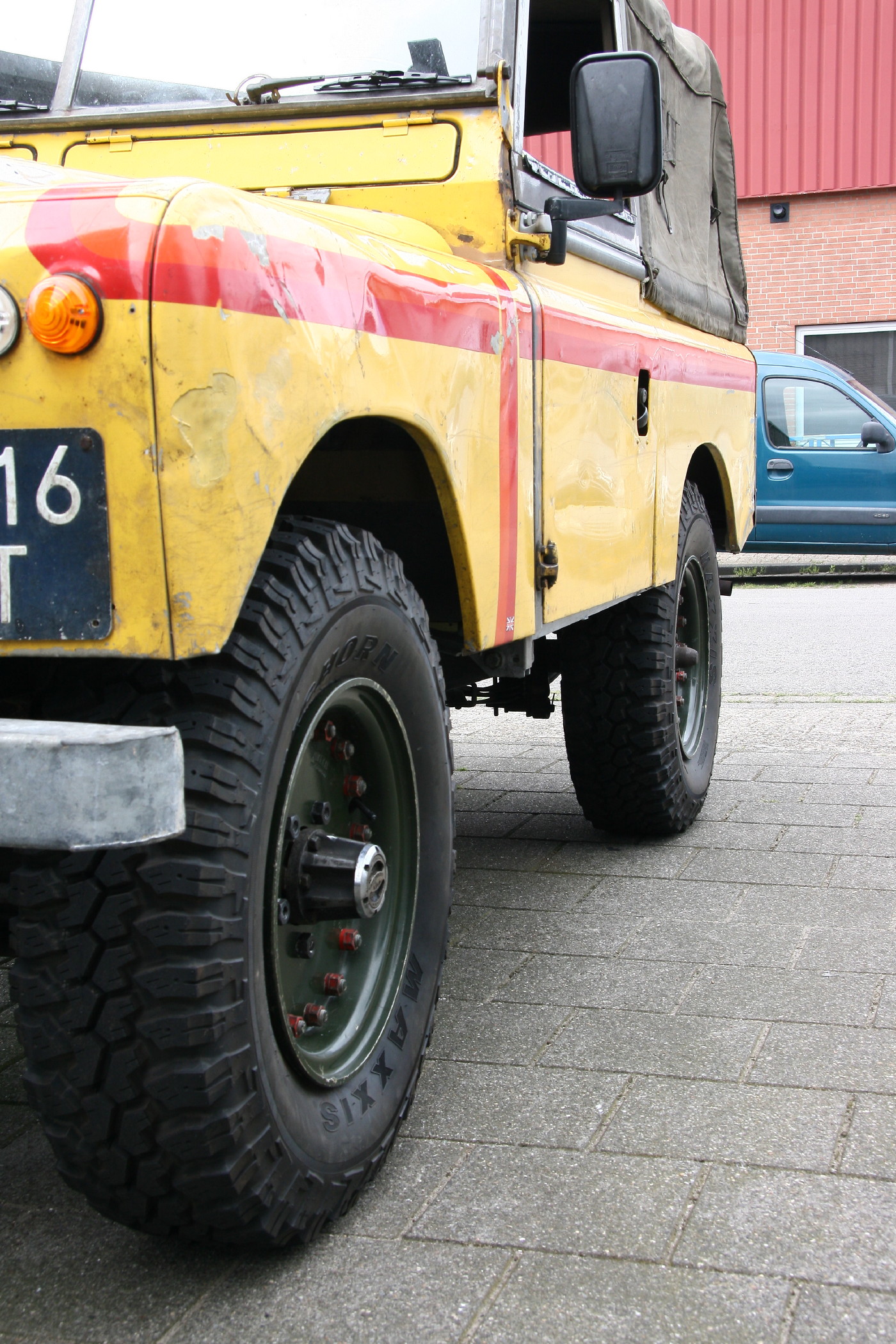

Here's some pics of my fresh set of 255/85R16 Maxxis Bighorns. Rims are 6,5" wide. Tyre is 33" tall.
Weight of one tyre is 25 Kg, compared to 42 Kg for a 900x16 that's a lot of rubber you don't have to pay. Compared to the 900's they are more comfortable too as they are rated for a lot less axle load. 2700 for these to 3400 Kg for 900's.
