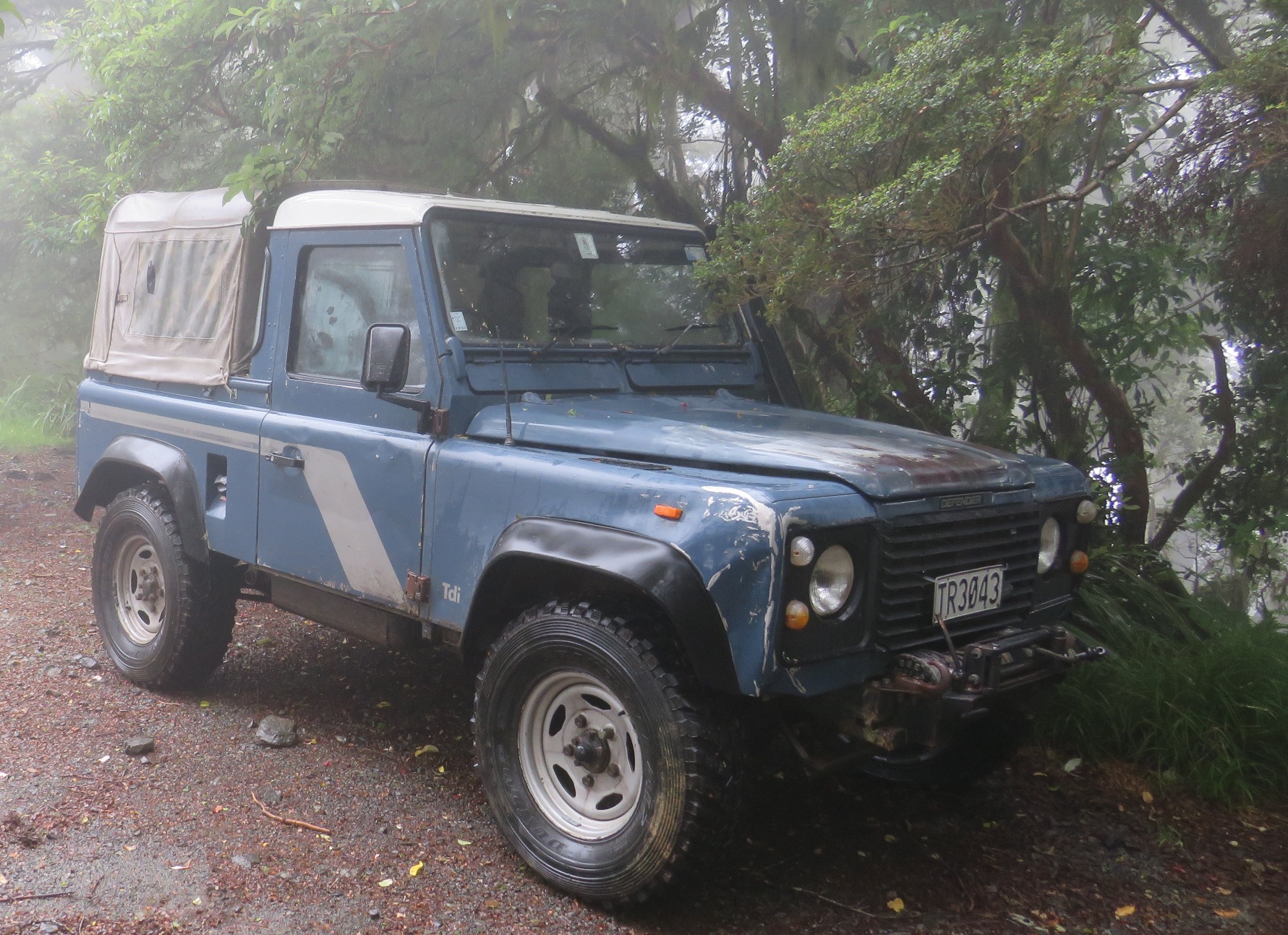

Postby NZ2AFC » Sat Jan 04, 2020 2:00 am
I have 285-75-16 on a D90, they are about the same size. They clear the panels ok.

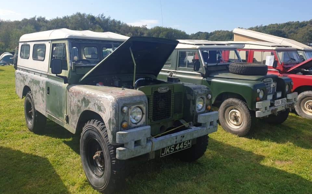

Postby Wannaoneton » Wed Feb 05, 2020 10:04 pm
I've seen them on 88's & 109's ....they look very similar to 255/85/16 .

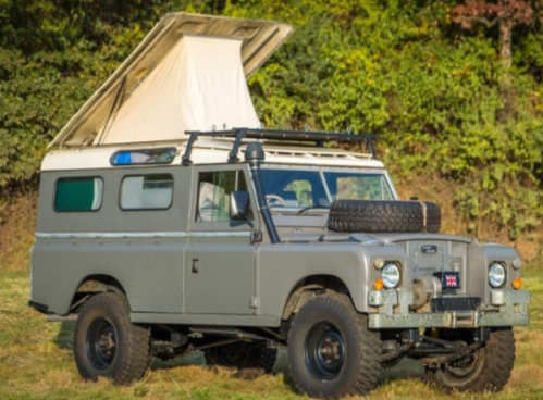

Postby Wannaoneton » Wed Feb 05, 2020 10:14 pm
8.25 x 16

Postby Wannaoneton » Wed Feb 05, 2020 10:20 pm
255/85/16
