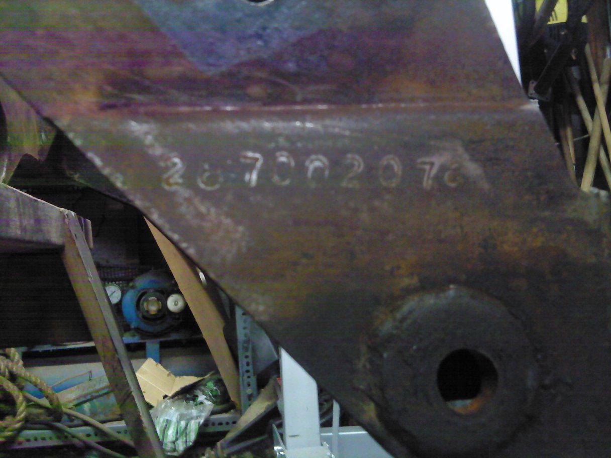

Postby NZ2AFC » Sat Nov 05, 2016 5:50 am
Mine is on the RH front dumb iron, see photo.
